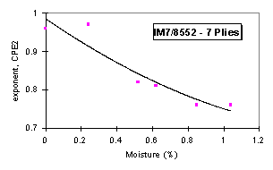

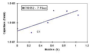

Moisture Content and Impedance Data
Correlation of moisture-sensitive circuit elements with moisture content in the 7-ply IM7/8552 monolithic composite sample.
Figure 14
