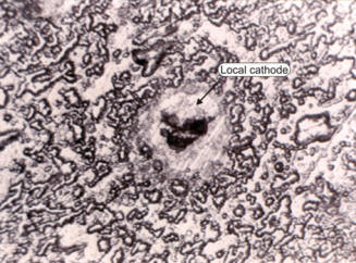

Theoretically, a local cell that leads to the initiation of a pit can be caused by an abnormal anodic site surrounded by normal surface which acts as a cathode, or by the presence of an abnormal cathodic site surrounded by a normal surface in which a pit will have disappeared due to corrosion.
In the second case, post-examination should reveal the local cathode, since it will remain impervious to the corrosion attack as in the picture of an aluminum specimen shown on the right. Most cases of pitting are believed to be caused by local cathodic sites in an otherwise normal surface.
