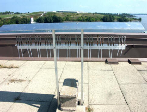

In a recent experiment carried out by the Corrosion Doctors, a modified atmospheric corrosion coupon (CLIMAT) was used in an intermittent testing regime to rank the corrosion inhibitive efficiency of corrosion preventive compounds (CPCs).
Atmospheric corrosion test rack for the evaluation of corrosion prevention compounds with a view of historical Fort Henry in the background

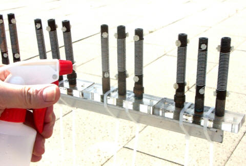

Corrosion acceleration by intermittent spraying of a 3% NaCl saline solution

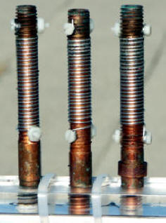

Control corrosion coupon after intermittent spray and exposure for ten days
Protected corrosion coupon after intermittent spray and exposure for ten days
Once cleaned the weight of the aluminum wires of these exposed CLIMATs was measured and compared to the initial weight to provide an estimate of the environmental corrosivity. The corrosion acceleration was quite successful since an average of 15% loss to corrosion was achieved on the non-protected coupons in ten days or 45% per month. In comparison, the most corrosive atmospheric test sites in North America, i.e. Kennedy Space Center corrosion testing facilities, can corrode the aluminum wires at the very fast rate of 30% per month during the most corrosive winter months of the year. Additionally, the coupons coming back from tests at this harshest test site in continental USA look very much like the coupon on the left side of the photos above.
