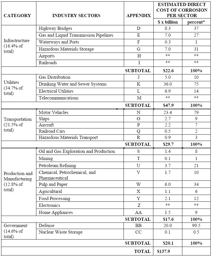

The second approach followed a method where the cost of corrosion was first determined for specific industry sectors and then extrapolated to calculate a national total corrosion cost.Data collection for the sector-specific analyses differed significantly from sector to sector, depending on the availability of data and the form in which data were available.In order to determine the annual corrosion costs for the reference year of 1998, data were obtained for various years in the surrounding decade, but mainly for the years 1996 to 1999. The total cost due to the impact of corrosion for the individual economic sectors was 137.9 billion dollars per year in the following Table.
Summary of estimated direct cost of corrosion for industry sectors analyzed in the 2001 study

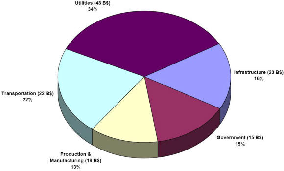

A breakdown of these costs by individual sectors is shown in the following Figure. Since not all economic sectors were examined, the sum of the estimated costs for the analyzed sectors did not represent the total cost of corrosion for the entire U.S. economy.
Corrosion costs breakdown across industrial sectors
By estimating the percentage of U.S. gross national product (GNP) for the sectors for which corrosion costs were determined and by extrapolating the figures to the entire U.S. economy, a total cost of corrosion of 276 billion dollars was estimated.This value shows that the impact of corrosion is approximately 3.1 percent of United States’ GNP. This cost is considered to be a conservative estimate since only well-documented costs were used in the study. The indirect cost of corrosion was conservatively estimated to be equal to the direct cost, giving a total direct plus indirect cost of 552 billion dollars or 6% of the GNP.
