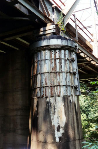

During the 1970’s, it was noticed that the concrete bridge piers were cracking and starting to spread apart. Steel plates were attached to the top of the piers and pressed against the concrete by using tensioned steel cables in order to confine the concrete and hold the piers intact. This was the last major maintenance performed on the old bridge.

This bridge pier has been confined with steel plates

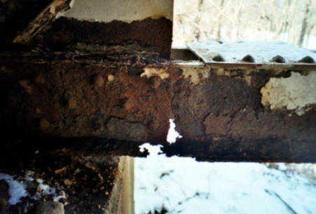

Perhaps the most serious structural problem is the rust
Parts of the laterals or their gusset plates have simply rusted through completely. Perhaps the most serious structural issue is with a support beam underneath the bridge on the southwest side.
The beam consists of two standard channels (members with a C-shaped cross section) riveted back to back to roughly form an I-beam cross section. One of the standard channels has rusted nearly completely though, so this beam is only able to support one half of its designed load.
