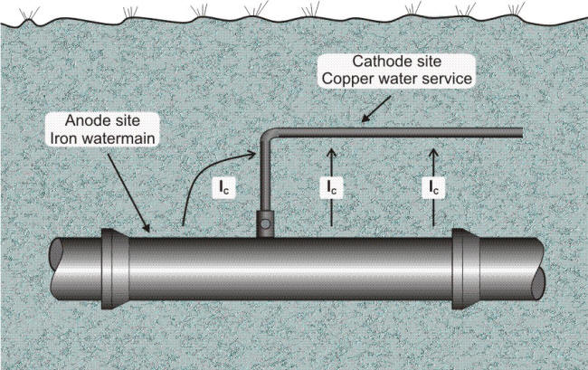

Are these corrosion cells common? The answer is yes. Whenever a copper pipe service line is directly connected to a cast iron gas or water main, a galvanic cell such as shown in the following Figure is formed. The soil is the electrolyte, the copper service line is the cathode, the iron (or steel) main is the anode, and the connecting circuit is completed by attaching the line to the main. Normally, such cells do not do any great amount of damage, because the anode (corroding metal) is so much larger than the cathode that the attack is spread out over a large area.
Underground corrosion cell involving connection of dissimilar metals

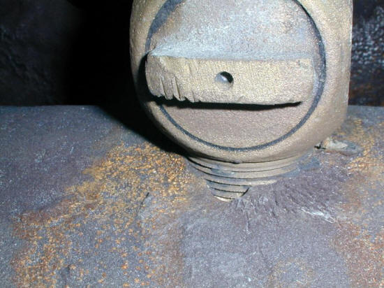

It can also be a problem when the surrounding soil is more conductive or corrosive in the region where the galvanic coupling exists as in the following Figure. In this example the anodic corrosion of the anchor is partly due to the galvanic corrosion cell formed by the connection of ground copper rods.
Corrosion of a water main ductile iron adjacent to a copper fitting
Corrosion of a water main ductile iron adjacent to a copper fitting. (Courtesy of Drinking Water Services, City of Ottawa)

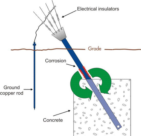

One way to minimize the dissimilar metal interaction that causes the corrosion of the structural steel anchor is to break the electrical path between these two components by adding insulators as shown below. However, this measure alone has proven to be only a partial solution to this type of problem since another corrosion cell is still active as will be described in the next section.
The addition of insulators between the ground rod and the steel anchor to stop the galvanic action
The addition of insulators between the ground rod and the steel anchor to stop the galvanic action. (Courtesy of Anchor Guard)
