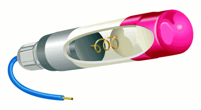

The silver-silver chloride electrode simplicity of fabrication and fundamental ruggedness makes it a good candidate for many industrial applications where the electrochemical potential has to been measured or controlled. The following commercial electrode is specifically designed to be embedded in reinforced concrete. (Internet reference 74)
