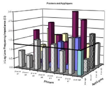

Difference in low-frequency impedance caused by a cyclic accelerated test for a series of primers and appliqués. Averages for each primer and for each appliqué are given on the right and front, respectively.
Figure 5

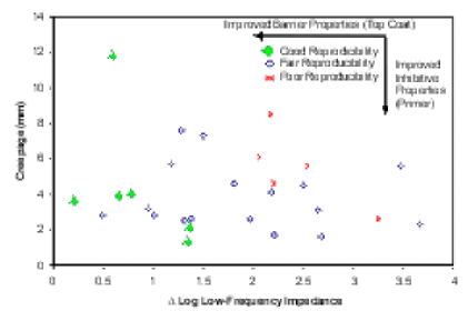

Creepage from a scribe as a function of the difference in log low-frequency impedance caused by a cyclic accelerated test for several top coat/primer systems. The best coatings would be near the origin. Also shown is a measure of the reproducibility from run-to-run and specimen-to-specimen. The best performing coatings have the best reproducibility.
Figure 6
