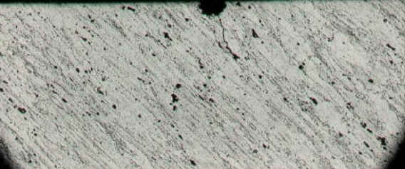

Section of a corrosion pit
Figure 4 A transverse section of a pit on the inner surface of the shock-strut cylinder. Note a fatigue crack nucleated from the pit.
Review of Pitting Corrosion Fatigue Models, D.W. Hoeppner, V. Chandrasekaran, and A.M.H. Taylor, University of Utah and FASIDE International Inc.
