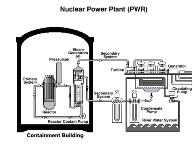

The BWR design consists of a single loop in which the entering water is turned directly to steam for the production of energy. The PWR design is a two-loop system that uses high pressure to maintain an all-liquid-water primary loop. Energy is transferred to the secondary steam loop through two to four steam generators. The PWR also uses a wet steam turbine.
Schematic representation of a pressurized water reactor (PWR)
