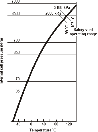

Internal pressure of a lithium cell
A function of temperature
The rise in internal cell pressure with temperature and the importance of a reliable vent arrangement to prevent cell rupture or explosion is shown here.
