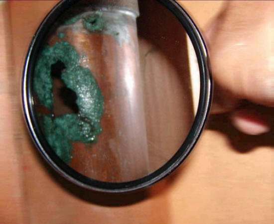

Piping is another major type of equipment subject to corrosion. This includes water pipes in the home as shown in the following Figure, where corrosion attacks mostly from the inside, as well as the underground water, gas, and oil pipelines that crisscross our land. Thus, it would appear safe to say that almost everyone is at least somewhat familiar with corrosion, which is defined in general terms as the degradation of a material, usually a metal, or its properties because of a reaction with its environment.
A common copper sink drain having suffered complete perforation after cleaning by a local plumber. (Courtesy of Kingston Technical Software)
