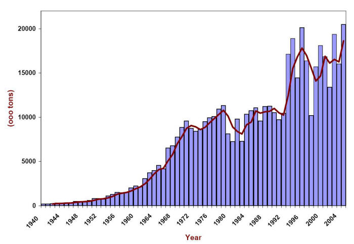

Snow fighting has a long history. However, the first use of salt for deicing roads can only be traced back to the 1930’s and it was not until the 1960’s that the use of salt in conjunction with plowing became widespread after winter maintenance personnel learned of its effectiveness. The following Figure presents the usage made of deicing salt or rock salt (mostly sodium chloride) in the U.S. between 1940 and 2005 . Initially confined to the ‘snowbelt’, ice fighting has become a priority activity in the ‘sunbelt’ too.
Usage of rock salt for deicing in the U.S. in thousands of tons. (Data from the Salt Institute http://www.saltinstitute.org/)

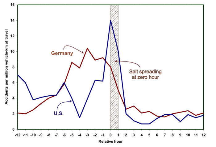

A study published in 1993 concluded that ‘As a winter maintenance service, deicing pays for itself within the first 25 minutes after the first hour that salt is spread on two-lane highways. Then, during the first four hours after the hour of application of salt, the direct road user benefits were $6.50 for every $1.00 spent on direct maintenance costs for the operation.’ The study found that costs related to accidents, including medical expenses, emergency services, workplace costs, travel delay, property damage, and administration and legal expenses decrease by 88% after the application of deicing salt. The following Figure illustrates the results of two studies of traffic accident rates carried out in two different countries (Germany and the U.S.) before and after salt spreading,
Statistics revealing the number of accidents before and after applying deicing salts
 Statistics revealing the number of accidents before and after applying deicing salts.

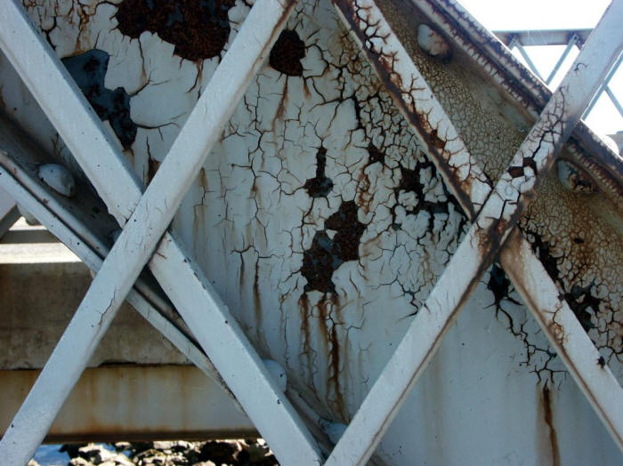

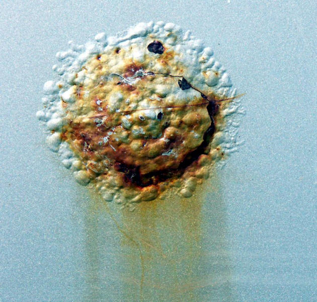

The impact of salts on protective coatings is widely recognized. Any breach or holiday in the coating will let salts reach the metallic substrate and initiate a very aggressive environment that in turn will force the coating to blister and peel off as shown in the following Figures.
Blistering and peeling of protective coating subjected to regular deicing salt application.
Filiform corrosion and paint blistering accelerated by deicing salt.

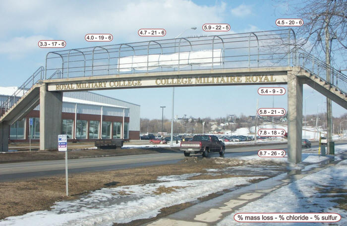

The effect of deicing salts extends much beyond the immediate vicinity where the salts are spread because these salts can travel as aerosol particles generated by the traffic circulation. The lifetime of any particular particle depends on its size and location. Studies of the migration of aerosols inland of a sea coast have shown that typically the majority of the aerosol particles are deposited close to the shoreline (typically 400 to 600 m) and consist of large particles (>10µm diameter), which have a short residence time and are controlled primarily by gravitational forces. Some studies have also indicated that there is a strong correlation between wind speed and the deposition and capture of aerosols.
The following Figure summarizes the results of a study using standard corrosion coupons deployed on a pedestrian walkway across a well traveled road during the winter months of a snowbelt city (Kingston, Ontario, Canada).
Results of a study investigating the transport and effects of deicing salt laden aerosols.
These results clearly indicate that the corrosion rates (% mass loss) while being highest closer to the ground (at the bottom of the pillars) are still appreciable many meters above the traffic level. For comparison, similar measurements made in non-trafficked areas of the same city typically showed corrosion rates fifty times smaller.
