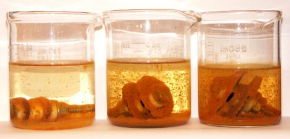

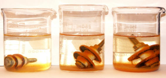

In order to verify that such corrosion attack did or did not occur on steel exposed to this harsh environment, the Corrosion Doctors decided to perform some experiments using the G78 MCAs and steel washers of three different sizes (1.5, 3.2, 3.8 cm) exposed to two different waters, i.e. one containing 3% sodium chloride in distilled water (to simulate seawater) and the other simple drinkable Kingston (Ontario) tap water or Great Lake treated best to be more precise. Here are two pictures of these specimens after a twenty-five day immersion of the assembled MCAs.
As you can see the salted water (top photo) is more aggressive to the steel washers generously sacrificing their metallic atoms in these experiments than those exposed to tap water (bottom photo). As Dr. Cottis would probably say, the steel is seawater is more active than the steel in tap water!
