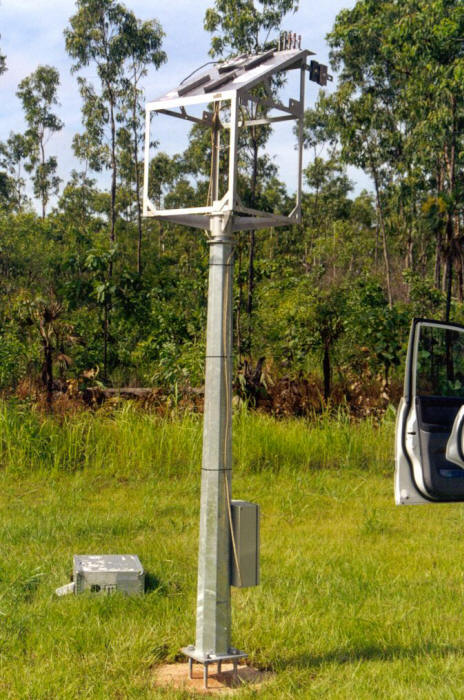

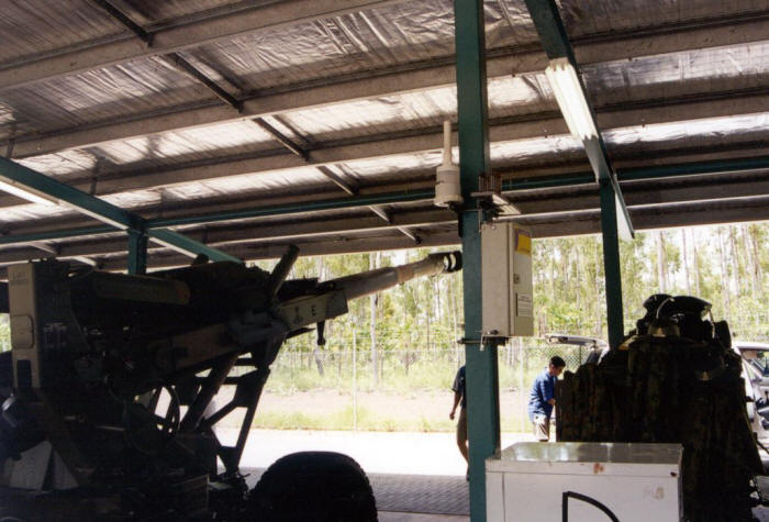

Cylindrical specimens are mounted horizontally, facing the same direction as the panels. They may be exposed fully to the weather or be partially sheltered, depending upon the requirements of the test. There is a great variety of test fixtures and shape of specimens used for environmental cracking tests. The following Figures show respectively a full exposure and a semi-sheltered test stations equipped with TOW galvanic sensors, temperature, and SO2 level recorded with a data logger.
Outdoor exposure test station with specimen rack on top and data logger attached below at an Army Base in Northern Australia. (Courtesy of DSTO Australia)
Semi sheltered test station with test coupons, wet candle apparatus, and data logger attached at an Army Base in Northern Australia. (Courtesy of DSTO Australia)

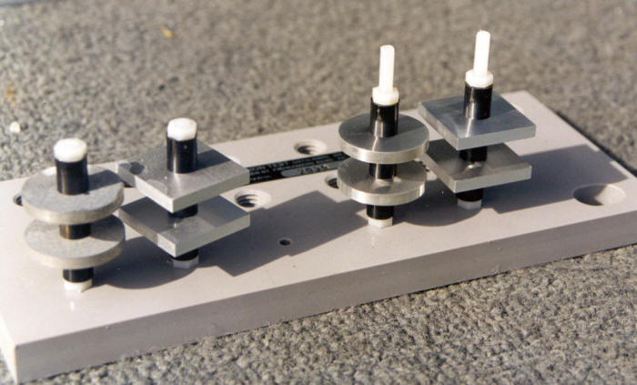

 The following Figure shows a custom built test rack designed to be mounted on a full exposure test station in order to reveal the atmospheric corrosion resistance of aluminum and magnesium alloys to crevice corrosion.
Aluminum and magnesium test specimens equipped with crevice spacers and mounted on a rack to be exposed at the previous test station. (Courtesy of DSTO Australia)

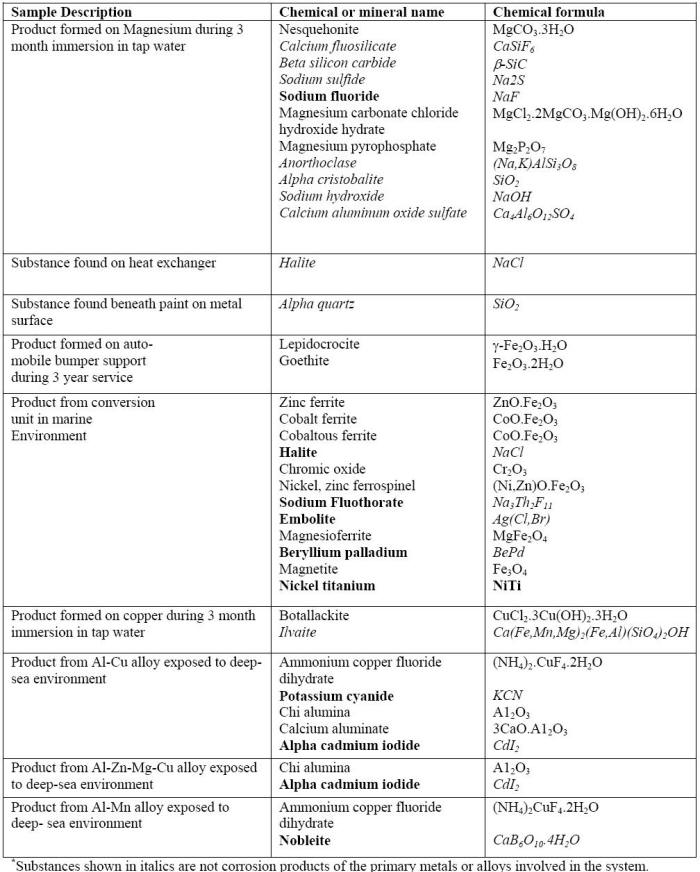

Generally, corrosion products developed by synthetic environments such as those produced in the ASTM B117 test are substantially different from those produced during natural weathering or even by wet-dry mixed salt spray tests. For example, corrosion of aluminum or zinc specimens in ASTM B117 primarily produces soluble species such as AlCl3 or ZnCl2 with little corrosion product remaining on their surfaces. Exposures in a wet-dry test, in contrast, cause the formation of corrosion products on those metals more representative of those formed during natural exposure. On aluminum, for example, hydrated alumina containing chloride and amorphous material are produced in both the high sulfate and high chloride cyclic salt spray tests. The reality can be even more complex as illustrated in the following Table in which it can be seen that the products found on specimens exposed to real environments often consist of corrosion products mixed with various foreign materials .
Results of X-Ray diffraction of products found specimens exposed to real environments.
