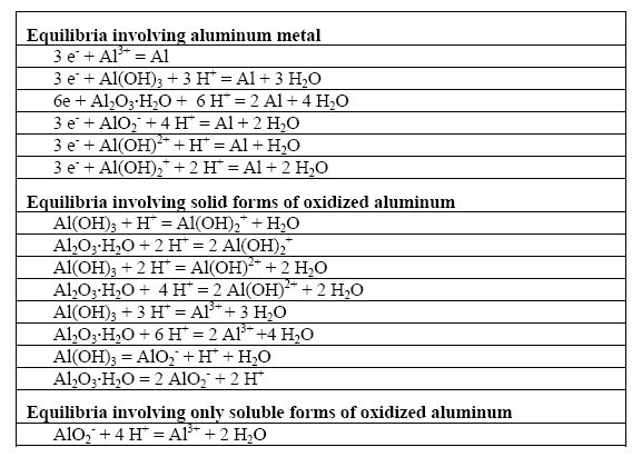

The next phase for constructing the aluminum E-pH diagram is to consider all possible reactions between the four chemical species containing aluminum retained for this exercise, i.e. Al, Al2O3.H2O, Al3+, and AlO2-. These reactions are summarized in the following Table.
Possible reactions in the Al-H2O system

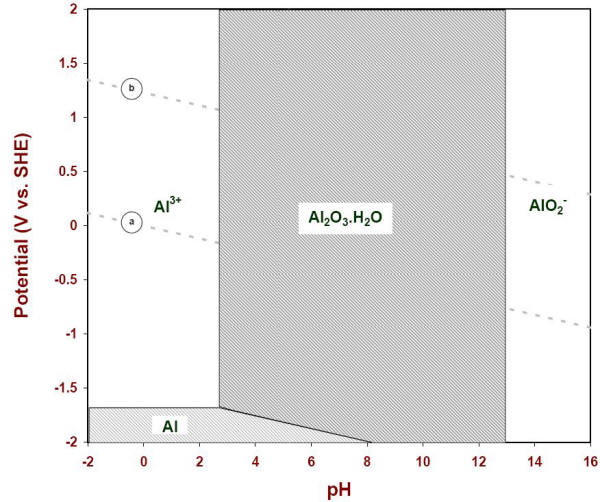

A computer program such as KTS-Thermo would compare all possible interactions and rank the chemical species involved in terms of their thermodynamic stability for all conditions of pH and potential would typically carry out this work. The following Figure illustrates the results of such computation for aluminum in the presence of water at 25oC when the activities of all species considered were set at value unity.
E-pH diagram of solid species of aluminum when the soluble species are at one molar concentration (25oC)
