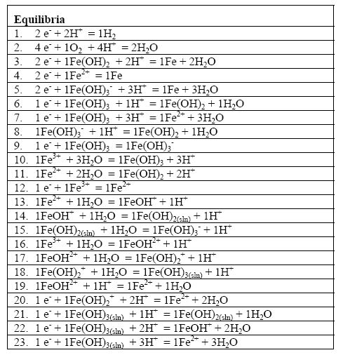

Possible reactions in the Fe-H2O system between the species most stable in wet conditions
